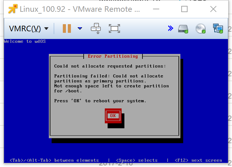

wmware下無法安裝WDOS

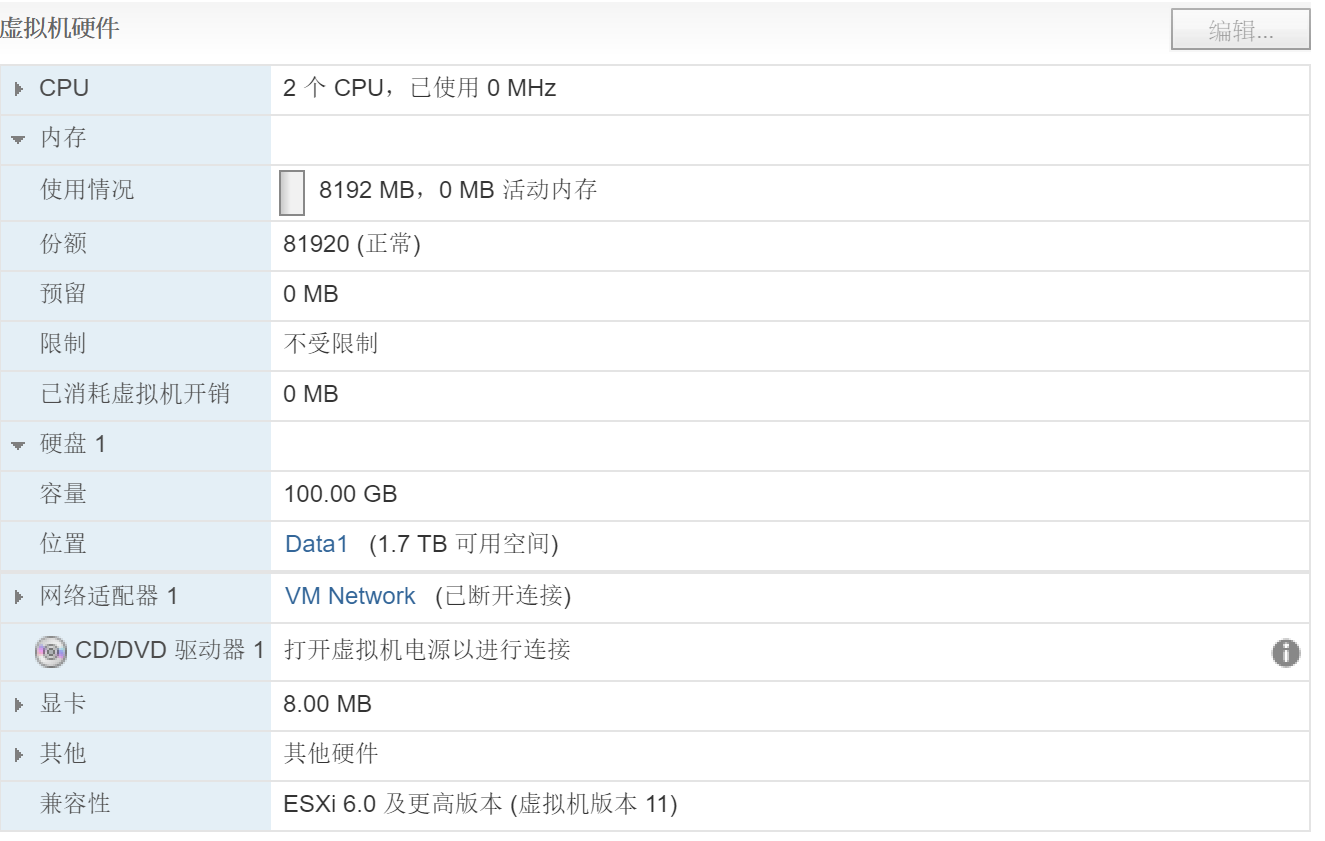

vsphere 6.5
(2017-9-8 11:36, 78.78 KB) / 下載次數(shù) 8062
http://ahbydz.com/bbs/attachment.php?aid=7967&k=a33ec65ec5a1ae58b9053cea8c61f4db&t=1746863622&sid=P0YFfd
(2017-9-8 11:36, 93.5 KB) / 下載次數(shù) 8012
http://ahbydz.com/bbs/attachment.php?aid=7968&k=3107bd63ae93c85c96323b90b84acc72&t=1746863622&sid=P0YFfd

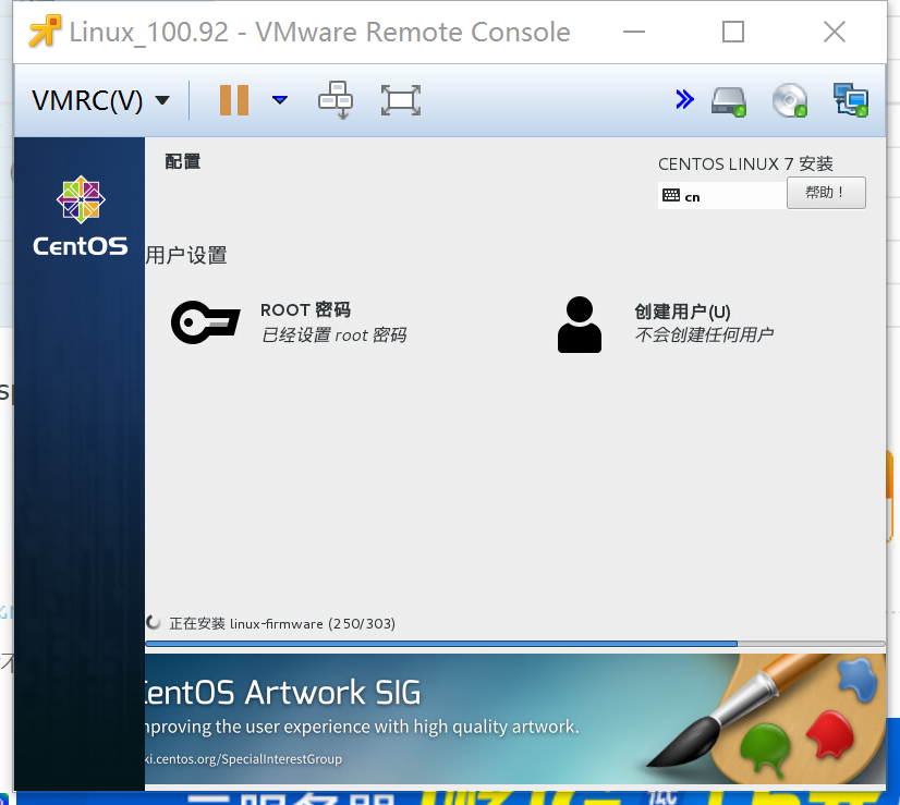

centos7可以正常安裝
(2017-9-8 12:05, 284.11 KB) / 下載次數(shù) 8201

經(jīng)過不停的測試,換硬盤,發(fā)現(xiàn)硬盤模式設置為sata可以,SCSI不行
