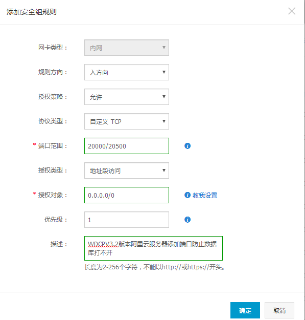

†–î}Ò»£º°¢ÀïÔÆ·þ„Õ(w¨´)Æ÷ÐÂÑb3.2°æ±¾µÄÐèÒªÔÚ°²È«½MÅäÖÃÒ»‚€¶Ë¿Ú
×¢£ºÒªÊDz»•þŪ°²È«½M£¬È¥°¢ÀïÔÆËÑË÷һϣ¬ºÜº††Î

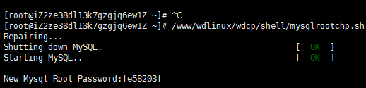

³õʼ”µ(sh¨´)“þ(j¨´)ŽìÃÜ´aÃüÁî
/www/wdlinux/wdcp/shell/mysqlrootchp.sh
