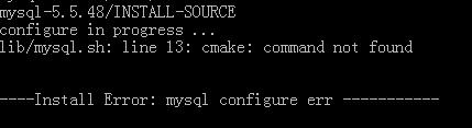

環(huán)境:CentOS / 6.5 x86_64 (64bit)裝不下去了~~
圖片附件: QQ截圖20160510105158.jpg (2016-5-10 16:19, 6.96 KB) / 下載次數(shù) 5857
http://ahbydz.com/bbs/attachment.php?aid=6081&k=73195e45da0e53537cd7d462272d4349&t=1747065836&sid=PGo0pi
作者: admin    時(shí)間: 2016-5-10 18:05
yum install -y cmake
試試
