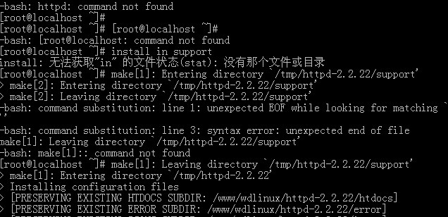

[root@IDC ~]# collect2: ld returned 1 exit status
-bash: collect2:: command not found
[root@IDC ~]# make[2]: *** [htpasswd] Error 1
-bash: make[2]:: command not found
[root@IDC ~]# make[2]: Leaving directory `/tmp/httpd-2.2.22/support'
> make[1]: *** [all-recursive] Error 1
make[1]: Leaving directory `/tmp/httpd-2.2.22/support'
make: *** [all-recursive] Error 1

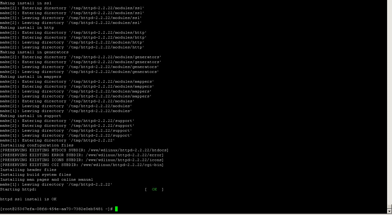

make[2]: Leaving directory `/tmp/httpd-2.2.22/modules/mappers'
make[2]: Entering directory `/tmp/httpd-2.2.22/modules'
make[2]: Leaving directory `/tmp/httpd-2.2.22/modules'
make[1]: Leaving directory `/tmp/httpd-2.2.22/modules'
Making install in support
make[1]: Entering directory `/tmp/httpd-2.2.22/support'
make[2]: Entering directory `/tmp/httpd-2.2.22/support'
make[1]: Entering directory `/tmp/httpd-2.2.22'
Installing configuration files
[PRESERVING EXISTING HTDOCS SUBDIR: /www/wdlinux/httpd-2.2.22/htdocs]
[PRESERVING EXISTING ERROR SUBDIR: /www/wdlinux/httpd-2.2.22/error]
[PRESERVING EXISTING ICONS SUBDIR: /www/wdlinux/httpd-2.2.22/icons]
[PRESERVING EXISTING CGI SUBDIR: /www/wdlinux/httpd-2.2.22/cgi-bin]
Installing header files
Installing build system files
Installing man pages and online manual
make[1]: Leaving directory `/tmp/httpd-2.2.22'
Starting httpd:                                            [  OK  ]
httpd ssl install is OK
已經(jīng)安裝  但是不知道可以不?

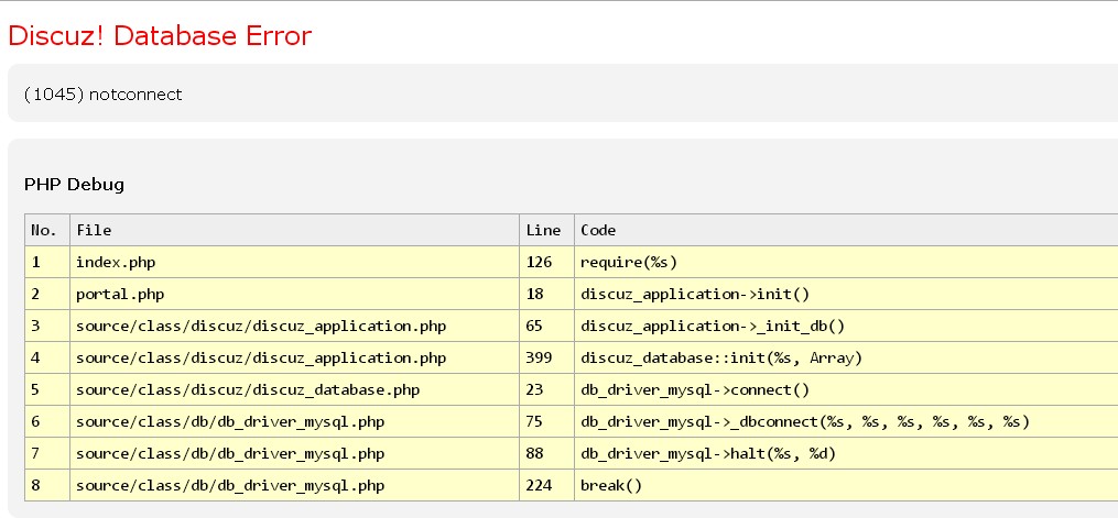

作者: qwer46060    時(shí)間: 2014-1-13 18:47
回復(fù) 1# admin
老大 我安裝好了
但是怎么無法聯(lián)機(jī)數(shù)據(jù)庫啊
我哭了 ······················
