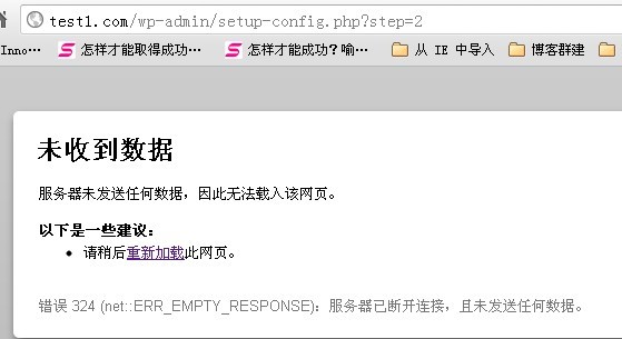

如題,我 的VPS是安裝的centos 5.6 32位的系統(tǒng)并安裝了lanmp_wdcp v2.4版的管理系統(tǒng),但是用nginx+apache和單獨nginx引擎安裝wordpress時在輸入了數(shù)據(jù)庫信息以后點確定出現(xiàn)502錯誤,nginx的錯誤日志代碼如下:2012/07/10 20:11:45 [error] 3269#0: *20 upstream prematurely closed connection while reading response header from upstream, client: 192.168.0.61, server: test1.com, request: "POST /wp-admin/setup-config.php?step=2 HTTP/1.1", upstream: "http://127.0.0.1:88/wp-admin/setup-config.php?step=2", host: "test1.com", referrer: "http://test1.com/wp-admin/setup-config.php?step=1"
用apache引擎安裝wordpress時出現(xiàn)如下圖錯誤

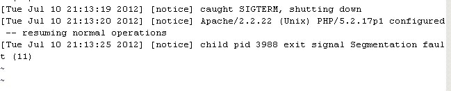

apache錯誤日志如下圖

圖片附件: error.jpg (2012-7-10 21:19, 34.03 KB) / 下載次數(shù) 6644
http://ahbydz.com/bbs/attachment.php?aid=931&k=7739a01d0afddf14ba3bc16b968e8630&t=1747074097&sid=vpuuTC
圖片附件: apacheerror.jpg (2012-7-10 21:21, 25.24 KB) / 下載次數(shù) 6651
http://ahbydz.com/bbs/attachment.php?aid=932&k=37875e17924cee23efc46bab43c43977&t=1747074097&sid=vpuuTC

作者: admin    時間: 2012-10-11 16:11
重新編譯下apache可以
具體可參考
http://ahbydz.com/bbs/thread-3657-1-1.html
