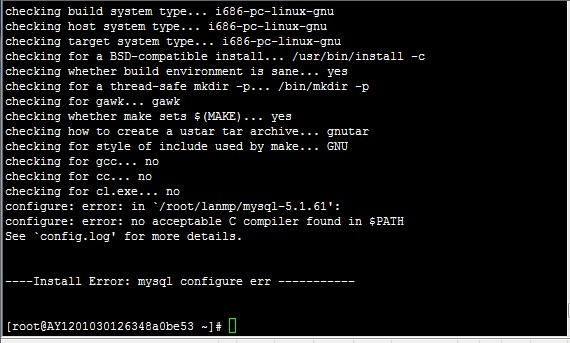

全新安裝的時候,install Error :mysql configure errr

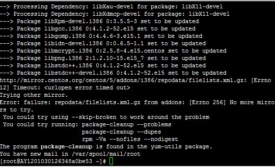

然后在下面鍵入
  1. yum install -y gcc gcc-c++ make autoconf libtool-ltdl-devel gd-devel freetype-devel libxml2-devel libjpeg-devel libpng-devel openssl-devel curl-devel patch libmcrypt-devel libmhash-devel ncurses-devel sudo bzip2
復制代碼
然后出現(xiàn)
  1. ---> Package libstdc++-devel.i386 0:4.1.2-52.el5 set to be updated
  2. http://mirror.centos.org/centos/5/addons/i386/repodata/filelists.xml.gz: [Errno 12] Timeout: <urlopen error timed out>
  3. Trying other mirror.
  4. Error: failure: repodata/filelists.xml.gz from addons: [Errno 256] No more mirrors to try.
  5. You could try using --skip-broken to work around the problem
  6. You could try running: package-cleanup --problems
  7. package-cleanup --dupes
  8. rpm -Va --nofiles --nodigest
  9. The program package-cleanup is found in the yum-utils package.
  10. You have new mail in /var/spool/mail/root
復制代碼
重新安裝還是出現(xiàn)最面的那個錯誤,install Error :mysql configure errr,也把

這個做了
圖片附件: 1.jpg (2012-3-11 14:50, 66.07 KB) / 下載次數(shù) 9566
http://ahbydz.com/bbs/attachment.php?aid=404&k=c6fabd3a86d163a9b48c2bff06e59e80&t=1747064507&sid=qb5Yq6
圖片附件: 2.JPG (2012-3-11 14:54, 94.26 KB) / 下載次數(shù) 9608
http://ahbydz.com/bbs/attachment.php?aid=405&k=9d36bfca84735a14b2be155522161501&t=1747064507&sid=qb5Yq6

  37. configure: error: in `/root/lanmp/mysql-5.1.61':
  38. configure: error: no acceptable C compiler found in $PATH
  39. See `config.log' for more details.
  40. ----Install Error: mysql configure err -----------

  129. http://mirror.centos.org/centos/5/addons/i386/repodata/filelists.xml.gz: [Errno 12] Timeout: <urlopen error timed out>
  130. Trying other mirror.
  131. Error: failure: repodata/filelists.xml.gz from addons: [Errno 256] No more mirrors to try.
  132. You could try using --skip-broken to work around the problem
  133. You could try running: package-cleanup --problems

  142. checking target system type... i686-pc-linux-gnu
  143. checking for a BSD-compatible install... /usr/bin/install -c
  144. checking whether build environment is sane... yes
  145. checking for a thread-safe mkdir -p... /bin/mkdir -p
  146. checking for gawk... gawk
  147. checking whether make sets $(MAKE)... yes
  148. checking how to create a ustar tar archive... gnutar
  149. checking for style of include used by make... GNU
  150. checking for gcc... no
  151. checking for cc... no
  152. checking for cl.exe... no
  153. configure: error: in `/root/lanmp/mysql-5.1.61':
  154. configure: error: no acceptable C compiler found in $PATH
  155. See `config.log' for more details.
  156. ----Install Error: mysql configure err -----------
復制代碼
作者: admin    時間: 2012-3-11 18:18
DNS錯誤,域名解釋不了
所以
這個也沒更新成功
作者: 阿飛劉    時間: 2012-3-11 19:39
那怎么解決
作者: admin    時間: 2012-3-11 22:35
換一個DNS
作者: 阿飛劉    時間: 2012-3-12 08:04
換虛擬主機的dns?
作者: 小蛋    時間: 2012-3-13 12:04
我有一臺5.4的也是這個問題。不理解咋 回事
作者: admin    時間: 2012-3-13 12:48
DNS不行,所以域名解析不了,所以yum更新不成功,所以沒有相關的依懶包和庫,所以安裝不成功
可以換一個DNS試試,可以看/etc/resolv.conf這個文件
